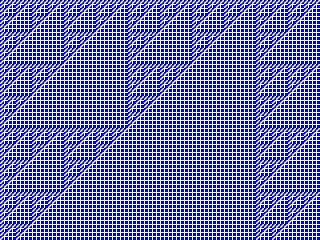

Sierpiński triangle:
CLS:FORY=0TO59:FORX=0TO79:VPOKE1,$B000+Y*256+X*2,78-((XANDY)>0):NEXT:NEXT
It looks better if you squint a little :lol:
And damn, BASIC is still slow as hell even at 8 MHz.

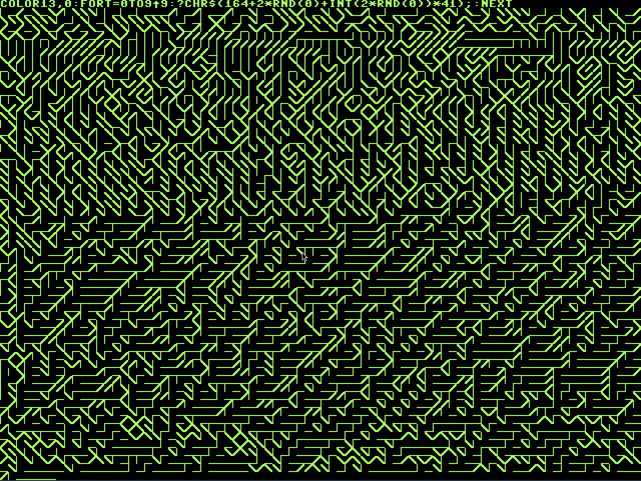

COLOR13,0:CLS:FORT=0TO9^9:?CHR$(164+2*RND(0)+INT(2*RND(0))*41);:NEXT
This one is interesting. If you watch it go for a minute, you can see the pattern go through a bunch of distinctive phases while the RNG "warms up", until it finally seems to generate more uniformly distributed numbers.
First it's lots of diagonals and vertical lines, then lots of horizontal lines for a while
then mostly diagonals but clearly biased towards one direction,
and only then the actual intended pattern emerges after about ~4 screens.
Re: Neat one-liners
That is unexpected and slightly worrying behavior of the rng...
When running the same oneliner on the C64 (in vice) there is no such 'phasing', it seems uniform right from the start....
(the same when running an equivalent program written in prog8)
Yeah, you should probably be using RND(1) instead of RND(0) in the BASIC oneliner, that seems to fix the lack of uniformedness on the X16.

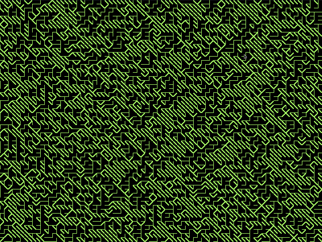

Is it allowed to cheat a tiny little bit by setting up a variable first?
If so, this is my entry:
first set up the variable:
M$=CHR$(145)+CHR$(17)+CHR$(157)+CHR$(29)
and then the one liner itself:
CLS:LOc30,40:FoI=0TO9^9:COlRn(1)*16:?Ch(209)Ch(157)Mi(M$,1+Rn(1)*4,1);:Ne
(yes, it uses token abbreviatons to fit it under 80 characters. They look a bit weird in ascii due to the case flip, if you paste the line in the emulator it does work correctly)
EDIT: it can be done on 1 line and so it adheres to the rules again, but it requires you to embed the actual characters into the line instead of using ascii-copyable chr$ notation:
1 = shift-Q , a ball
2 = cursor left
3 = cursor up
4 = cursor down
5 = cursor left
6 = cursor right

I made it into a one liner but you can no longer copy paste it from the forum because of the embedded control characters that you have to type now ;)
