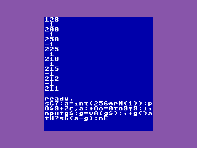

This game, called Guess My Border Color, can be pasted into the emulator (R43), then press Enter:
Sc7:A=INT(256*Rn(1)):Po$9F2C,A:FoO=0TO9^9:LINPUTG$:G=Va(G$):IFG<>ATh?Sg(A-G):Ne
You enter guesses of the border color between 0 and 255 in decimal. It replies -1 if the answer is lower, and 1 if the answer is higher, and quits if you guess right. Paste again for a new round. It is considered a win if you guess correctly before it begins to scroll.
Guess My Border Color by mobluse
The expanded code is:
SCREEN7:A=INT(256*RND(1)):POKE$9F2C,A:FORO=0TO9↑9:LINPUTG$:G=VAL(G$):IFG<>ATHENPRINTSGN(A-G):NEXT
but that doesn't fit in the input buffer.
If you paste this once in a session before pasting the oneliner you get a more random border color:
?RND(-TI)
