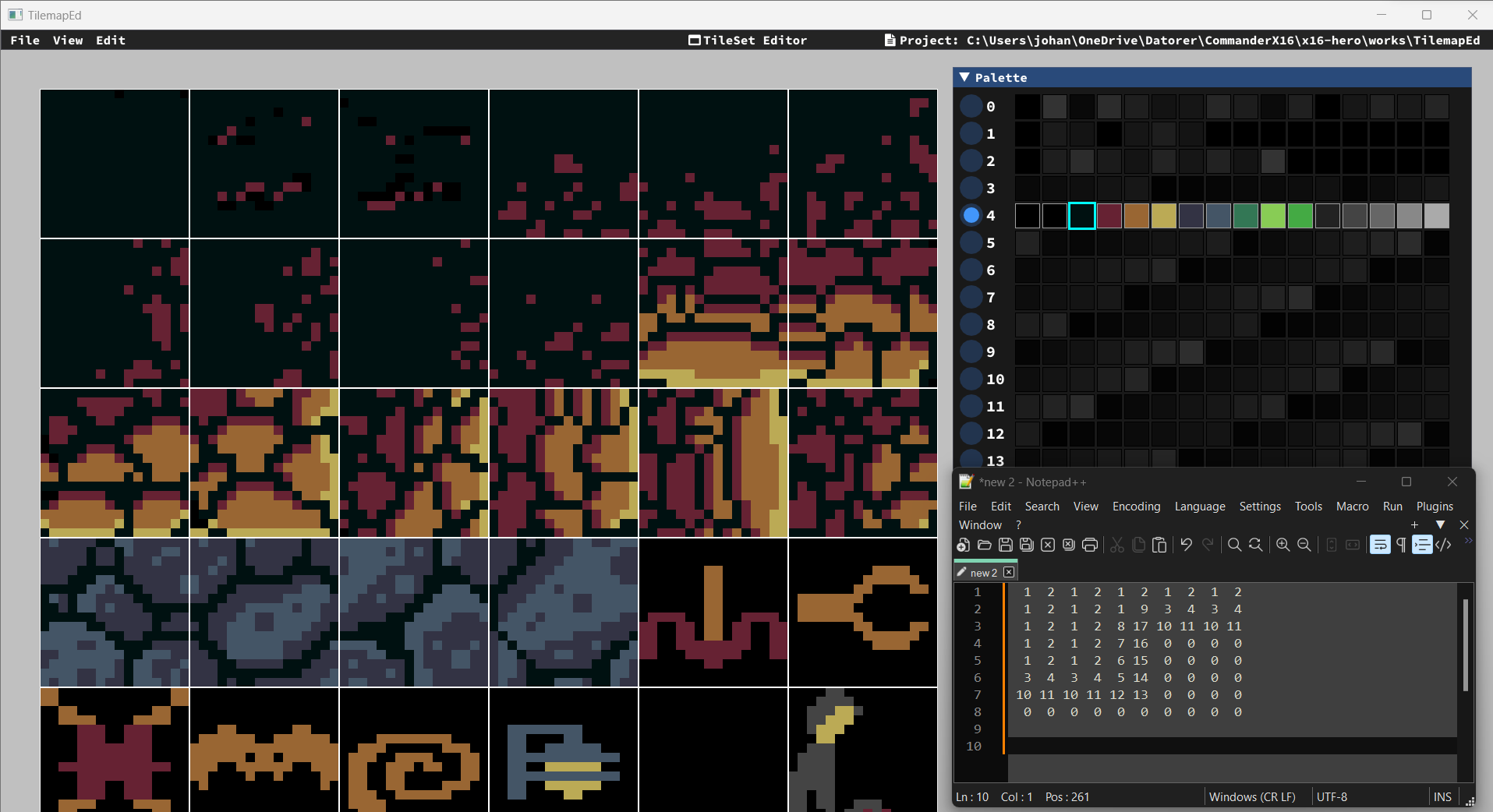

Hi, I am back again working with TilemapEd, I haven't done anything during the summer. For the first time, I am drawing tiles that I intend to use in my finished game. This means I am not just drawing a few tiles for testing purposes. One thing that I immediately realized is that it would be very useful to show the tiles' index numbers, both when looking at the tilesets themselves and the tilemaps.
If you look at the screenshot I have attached, it is not apparent how the tiles are meant to fit together. Therefore I have a small text file where I am trying to note this by building a small tilemap consisting of index numbers. But when doing this I have to count manually to see that it is number 4 that is meant to be above number 11 and then write that down. If I rearrange the tiles I have to start over and update everything I have written.
When using PyxelEdit, I could build an example tilemap just to clarify how bigger structures were built up. I could choose to display all tile numbers above each tile on the map to easily see how they fit together. Because of that, I didn't have to write any information down.
Oh, one more thing, when zooming in tiles, I don't get any scrollbars. This means that I am just able to see about the first 25-30 tiles when zooming in.

Hello Johan
I've been so busy with my game I didn't see your post here : )
Regarding Tile numbers I've already been thinking about ways to create Text Overlays for showing the "Collision Values" in a TileMap, a suggestion from FearLabs. I guess the same code could be used for TileSets to show Tile numbers.
I'm not sure what you mean by scrollbars? If it's the TileSet editor you mean, the way it works is that you hold down "Left CTRL" and then drag the TileSet with "Left Mouse Button".
The reason for this is that the tiles in TileSet editor are rendered using pure SDL, so there's no way to add scrollbars (Unless I make my own SDL Scrollbar widget, which will probably not happen any time soon : ) )
