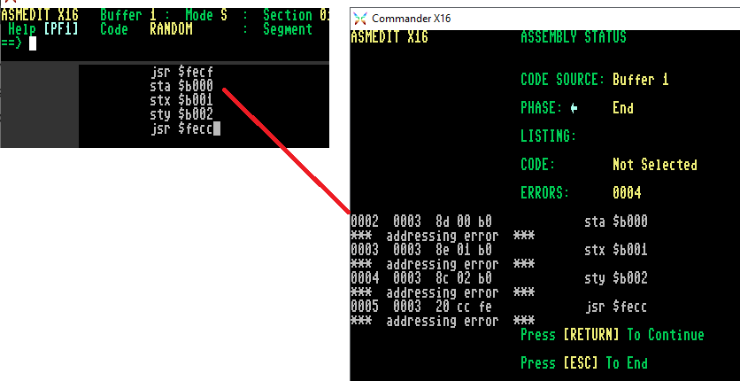

Should these pass validation?

Yes, but the problem is that ASMEDIT only lets you create code above address $ff
if you specify, for example, *=$400 on the first line the assembly should not fail.

I think the error is where it's trying to put them, not the instructions themselves... (The opocodes and the addresses associated with them are ok.)
But they seem to be trying to go into zero page. Did you forget the *=XXXX start point?

Yep, I forgot that line at the top, forgot we're back in 1980 again :P
Ok, I put " *=$0400" at the top. Now it passes validation. Yeehaw!
