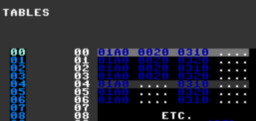

With some wonderful help from folks on #asm-dev on the Discord, I've managed to get effects working!
The effect param numbers will surely change, but the above does a pitch slide on channel 1 and a volume slide on channel 2. Right now pitch can wrap (just like it does on the GameBoy/LSDJ) and I haven't decided if I wanna keep that. Volume also wraps and encroaches on the panning bits but I'll fix that soon. I don't expect I will wrap volume.
I plan on adding some of the easier effects first, notably vol/pitch slide (up AND down), PWM (perhaps both slide up/down and set to specific value). I still want some channel effects (e.g. speed, pattern cut, jump to order, etc.). Some of the fancier effects, such as arp, will require storing more state.
These are implemented via a jump table, which is why the effect #'s are 00 and 01. I still want to have letters eventually. For that I'll likely use a PETSCII to effect # mapping array just like I have for keyboard-to-note (e.g. 'Q' on the keyboard is C-1 + octave). I am also planning on either sharing global effects across PSG, FM, PCM or only allowing them on the PSG channel. FM and PCM will have their own effect jump tables. This is for reuse to support multiple effects while hopefully not running out of alphanumeric characters to define effects. Or I can just keep doing it the way I am now (hex values). It's just more typing and less screen real-estate that way (see previous posts for my ideas on this).
There is a problem with some of these effects though as exist in pattern data. I'm doing a pretty naive evaluation of volume and pitch where I just subtract the value from whatever is in the channel registers. This means trying to do something like a kickdrum doesn't work without making the song speed go super fast.
I could remedy that by making the routines more complicated and storing more state where I evaluate the effects via the sound engine update routine (which runs at vsync). Some effects will require this (like arp). I still might but I kinda like that these are coarse and the more state I track, the more memory and overhead I have to deal with. And they're only coarse when doing very fast slides at slowish song speeds.
My current preferred way to solve this is via a feature I've been talking about quite a bit - Tables/Macros. Here's a dirty mockup:
Much like LSDJ on the GameBoy, one can assign tables to instruments but these can also be changed via a pattern effect. Tables would be evaluated at engine speed (again currently vsync) which is the same speed envelopes are evaluated at, perhaps optionally with a speed divisor. These are sort of like sub-patterns in a way.
Since they run at engine speed, pitch slides would be basically as smooth as I could make them without doing something crazier and in doing some tests, I think would be perfectly sufficient for some good ole chiptune PWM kickdrumz.
Notice also that they support up to 4 effects. This one way to work around not having multiple effects per channel. The number of effects with this implementation would be hard set and might change, though I think 4 is sufficient (that's double what LSDJ supports). I arbitrarily picked a length of 32 since that gives me 256 bytes which means, much like envelopes, table-math would be easy but would only provide 32 tables.
I'll also need to define whether or not they loop (and perhaps direction - forward or ping-pong). In LSDJ, you stop tables from looping via an effect and can also shorten the loop via another effect. I'll likely support the latter. The former I'm debating on if that should be an instrument flag and a configureable pattern effect, optionally using the unused bits of the effect value. Since there are only 32 tables in this implementation, I can use the top 3 bits of the byte as flags/modifiers for the tables.
I don't expect I'll have all this done right at the get-go but I really want some sick chiptune kicks and feel that's a pretty important feature. Not just kicks but being able to do more complicated modulations in general without having to use envelopes (noting they can have limitations too).
It's a pretty huge feature but one I'm fairly excited to get to and will probably start work on it once I add some basic pattern effects as noted above.
