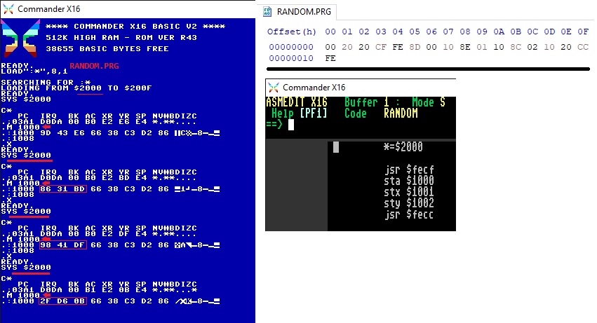

Trying new version and having trouble.
First, I RUN the loaded PRG.
- Create new file
- F3 to enter EDIT mode
- Enter the sample .SOR to generate random numbers (as described earlier). The forum isnt letting me attach .SOR files, so may have to type it in.
- use ESC and SHIFT+X to save the file, creates the .SOR file to disk
- x to exit, get back to menu, Generate Code
- this makes SAMPLE.PRG as attached below
I think the code generated is fine - it matches what I used in the earlier discussion. So issues are:
- I can't use CMDR-DOS LOAD command. Does that always try to load to $801? If so, that's fine
- instead I use BLOAD "SAMPLE.PRG",8,1,$2000 (because the code is .org'd at $2000)
- the code calls RNG, writes the results start at $1000, then goes to MON (so you can view the result)
But in the MON, I'm never seeing the result at $1000 as expected.
Thoughts? And if you're on Discord, can you share some other .SOR examples we can use on the SD-card? Simple stuff, just to show the workflow here.
I'm using R45.
SAMPLE.PRG
(17 Bytes) Downloaded 626 times

I understand your program to be as follows:
*=$2000
20 cf fe jsr entrogy-get ;get 24 random bits
8d 00 10 sta $1000
8e 01 10 stx $1001
8c 02 10 sty $1002
20 cc fe jsr monitor
LOAD"SAMPLE.PRG",8
This command loads the program to $0801 ignoring the first two bytes (i.e. the location address: $2000) which is incorrect.
BLOAD"SAMPLE.PRG",8,1,$2000
This command loads the program to the correct address ($2000) but includes the two byte header as part of the program, which is incorrect.
The correct way to load the program is with
This command uses the first two bytes to determine the program location, but is not included in the loaded code.
With regard to more examples, there is a 'HELLO WORLD' example in the new version of the reference manual with a YOU TUBE video
link so you can follow the work flow. https://youtu.be/HTeLqSqDS84
Hope this helps
