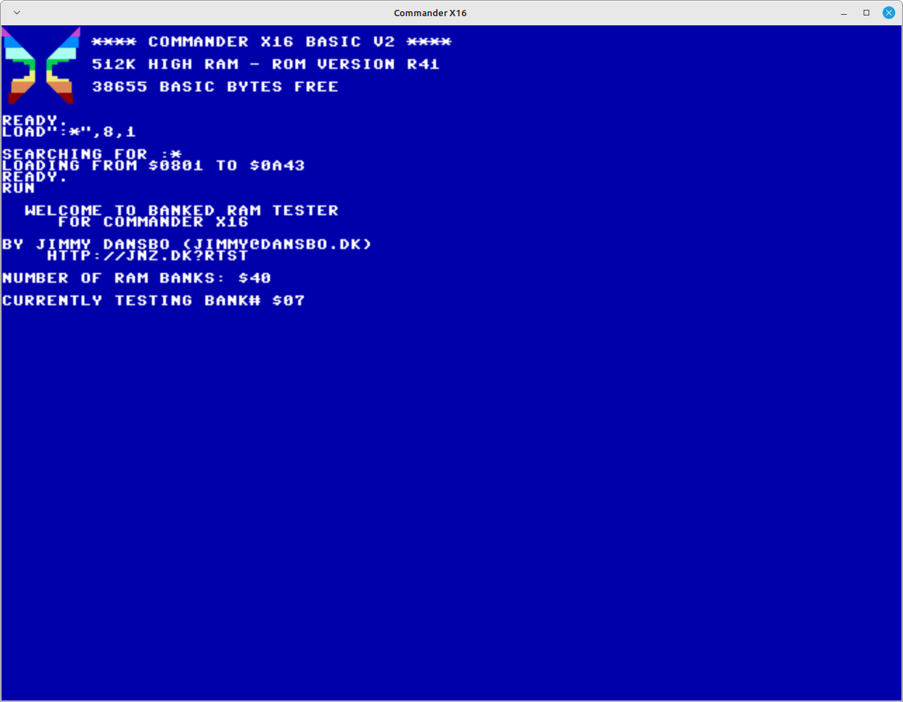

Test banked RAM on the Commander X16 for errors.
All available banks, except 0, are tested. If an error is found, the address is reported and the test stops.
Download here:
RAMTEST.PRG
(580 Bytes) Downloaded 704 times
For more information on how the software works, visit https://github.com/jimmydansbo/ramtest/
