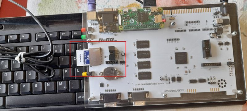

the flashair card is wonderful.
I also have one in the n-go.
can use it to move programs from the notebook to the n-go and back.
wonderful.
this is main connection n-go - notebook :
flashair updir pebinex : 192.168.0.1/upload.cgi?UPDIR=/pebinex/
flashair updir fth : 192.168.0.1/upload.cgi?UPDIR=/fth/
flashair updir inc : 192.168.0.1/upload.cgi?UPDIR=/tools/vforth/inc/
flashair updir lib : 192.168.0.1/upload.cgi?UPDIR=/tools/vforth/lib/
flashair updir data : 192.168.0.1/upload.cgi?UPDIR=/data/
flashair upload : 192.168.0.1/upload.cgi
flashair del : 192.168.0.1/upload.cgi?DEL=/
wonderful.
