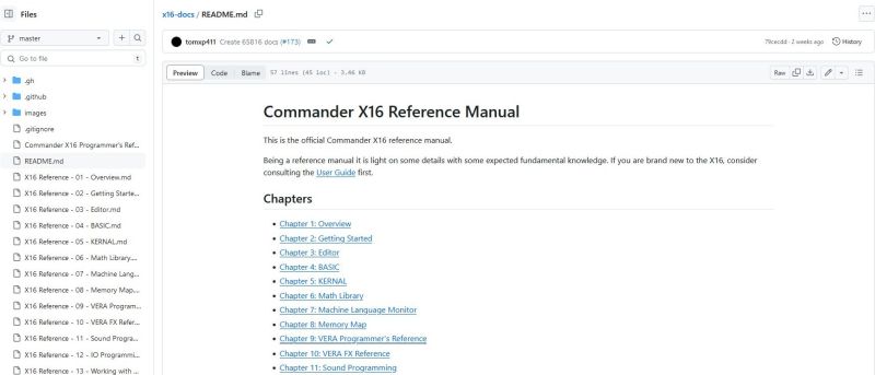

Are all sys commands in there from basic for asm with jsr... in the x16 doc ?
lda #4
sta $01 ; rom bank 4 (BASIC)
thanks

Re: Memory Banking Question
Those are not published APIs, so the address for those can change between builds.
If you want to inspect the code to see how it works, you can check out the ROM source code on the Github Repo. Otherwise, we're not going to publish the addresses for the BASIC ROM routines, because they are not fixed and will change from one release to the next.
It doesn't list the addresses to JSR to for the BASIC commands ..
poking around the ROM repo, I think I understand why that is ...
https://github.com/X16Community/x16-rom ... ic/basic.s
https://github.com/X16Community/x16-rom ... c/tokens.s
The way the ROM is currently assembled, the addition or removal of any BASIC keyword would result in the table addresses changing..
Changes to the functions themselves would shift the final address of the subroutine.
BASIC does not provide an API in the way that the KERNAL does.
consider this -
https://github.com/X16Community/x16-rom ... /vectors.s
No matter what may change about the underlying implementation or if new Kernal functions are added later,
.segment "JMPTBL" will always provide good location to some KERNAL function...
If there is some BASIC function you want to call from ASM, you would need to do it some other way - possibly could incorporate the code from the ROM repo for that bit of BASIC, otherwise would need some way to ensure that your program is calling into the correct location in the BASIC bank
the timing man... heheTomXP411 wrote: ↑Tue Apr 09, 2024 11:17 pmThose are not published APIs, so the address for those can change between builds.
