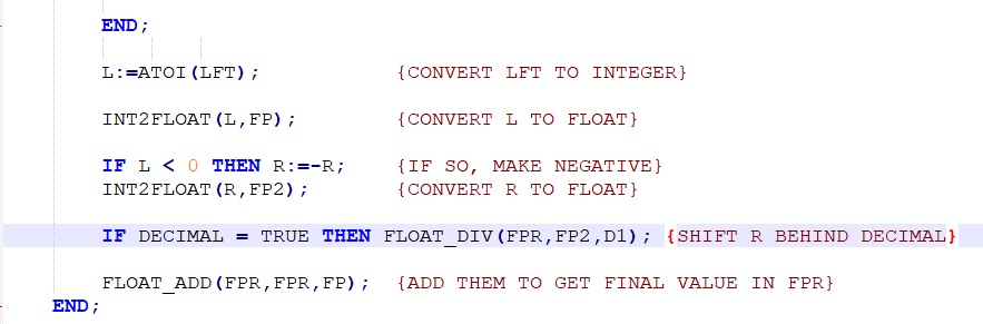

Here is another piece for using floats, should anyone actually want/need to use floats; ASCII to float conversion. The ROM routine to do this can't be used, since the compiler and or interpreter, stomps all over the zero page locations that the BASIC routine depends on. Demonstration program attached. It works, except when it doesn't :roll: , which results in being kicked into the monitor. Mostly it works, perhaps I'll find the bug.
Bug found (more may lurk :lol: ), updated attachment. It appears that floats and their pointers need to be global. I'll see if I can figure that out.
Third time is a charm! New version of atoftest.pas attached.
