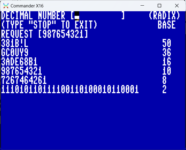

Here is a utility I did last year for converting a given decimal value into different Base numeric systems (Base-2, Base-8, Base-16, Base-36, Base-50). See the end of the code example for going up to Base-89 (with the max reasonable-printable characters on this system).
The example here is a pure radix numeric conversion. But this similar concept of base conversions can be a way to transport binary data across systems, as a given binary sequence can be represented by a higher-base character (embedding images in e-mails works along similar idea, see Base64 and MIME encoding - those encodings do work slightly differently than a pure numeric base conversion).
It is also an example of using BASLOAD to define some re-usable "function-like" structures (like for getting user-input capped to a certain length).

- baseconv.png (24.24 KiB) Viewed 17010 times
