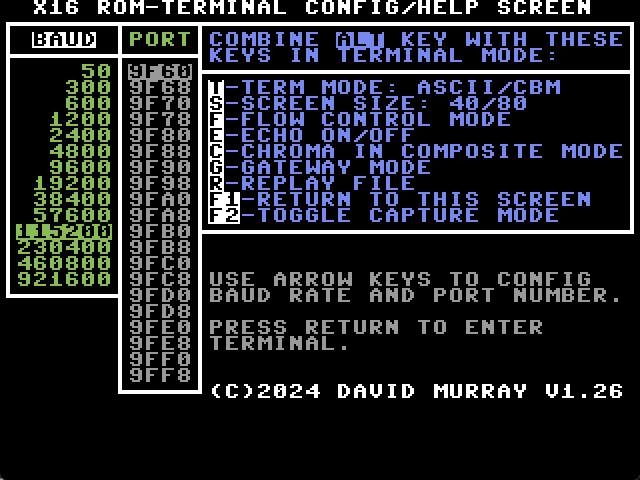

Version 1.27 fixes more bugs, especially with gateway mode.
Version 1.26 adds a better capture/replay mode.
Version 1.24 fixes a bug that caused inbound data to be dropped when typing.
Version 1.23 adds ANSI bugfixes and a hidden feature, "gateway mode" which can allow another computer to use the serial port on the X16 to gain access to the internet. Press G at the setup screen to activate.

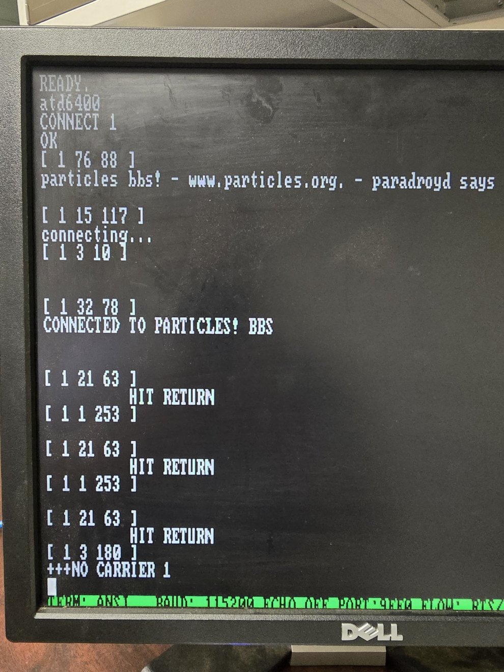

I was able to get the software working and made a connection to Particles BBS, but something is not right. I get a welcome message from the BBS and another stating that I'm connected, but then I get a couple instances of the following message:
[ 4 21 63 ]
Hit return
[ 4 1 253 ]
Followed by "No Carrier" which I assume means the BBS disconnected me. No login prompt ever appears.
Any ideas?

Re: ROMTerm V1.21 (Terminal Program)
What happens if you hit Return (or Enter) when it says 'hit return'?

Post by elscorcho »
Particles BBS Session
I hit return after every prompt as shown in the screenshot.
I should mention I also tried another BBS and it connected but I received no more output after that.

Hi all,
I found a firmware update posted by Kevin Williams in the Facebook group that fixed the issue. All works perfectly now. Thanks to David M for a great piece of software!

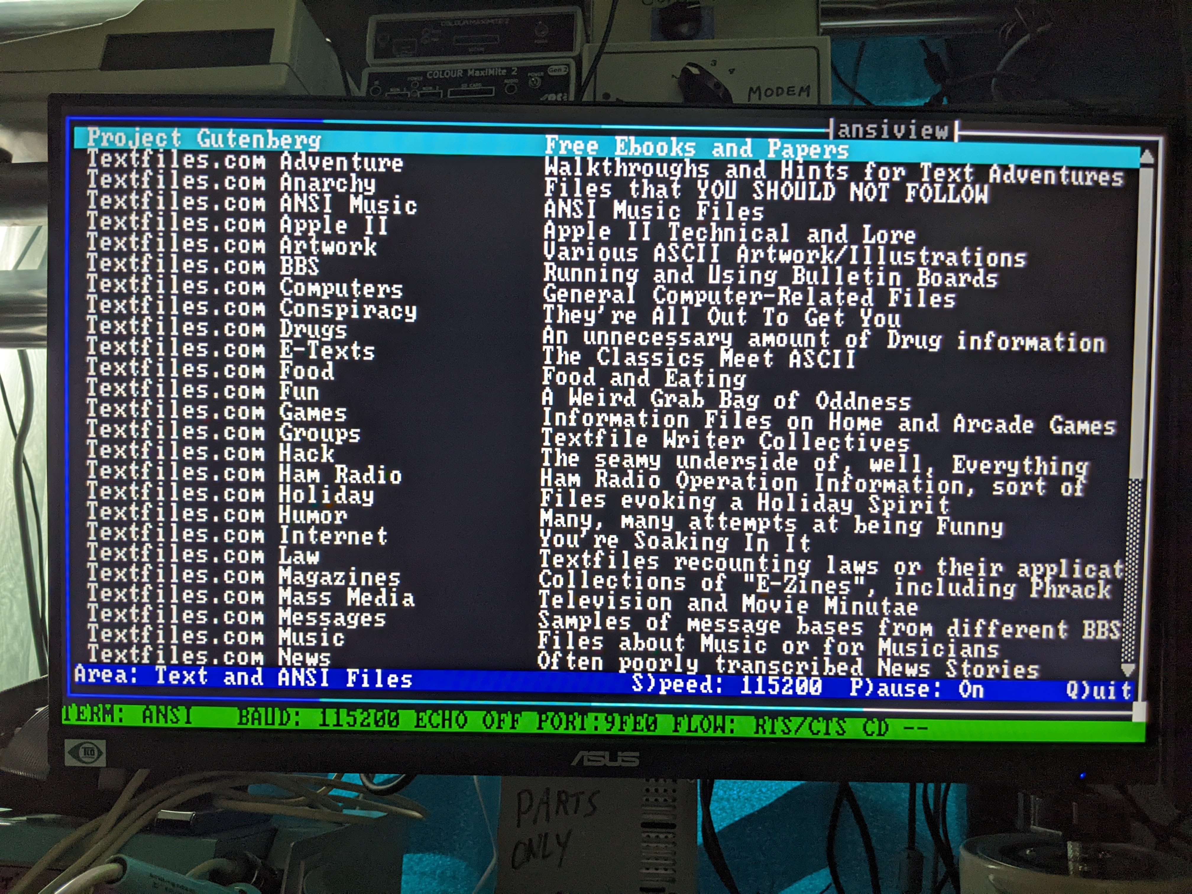

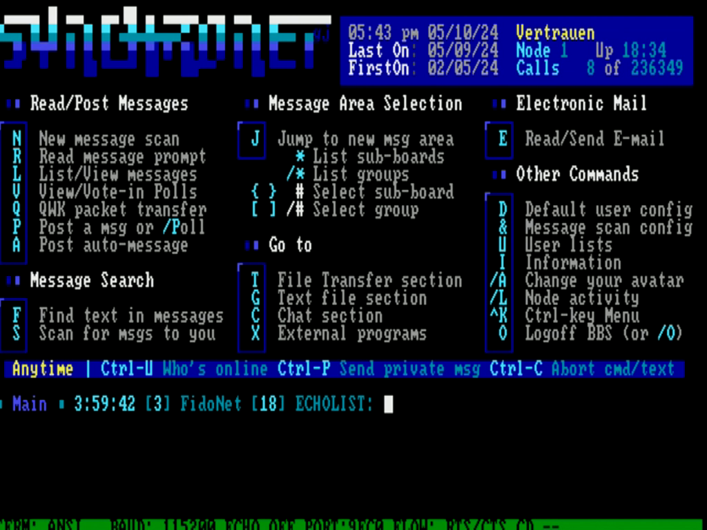

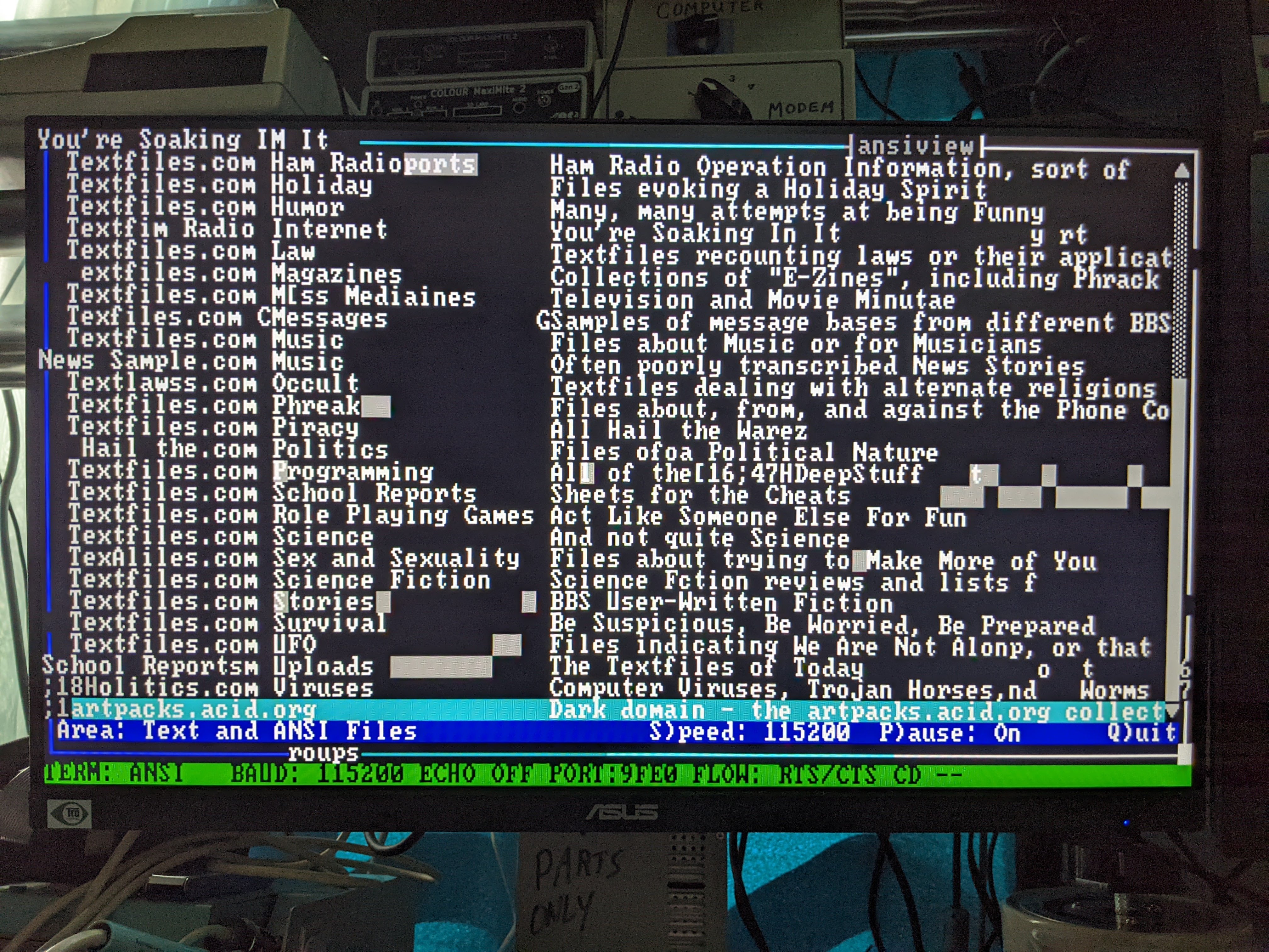

Is there a procedure or place where we should post bug reports? I've discovered that I can trigger pretty severe screen corruption while using the network card to connect to endofthelinebbs.com and viewing their ANSI library at 115200 Baud (RTS/CTS Enabled) on the X16. If I go to one of the categories in the file browser door and just hold down the arrow key to scroll up or down, ROMTerm seems to be unable to handle the screen redraws quickly enough and lots of screen corruption happens.
Steps to reproduce: Run ROMTerm 1.23. Select 115200 Baud, RTS/CTS, ANSI. Connect to endofthelinebbs.com
Once at Main Menu, hit X for External Programs, 1 for Main Programs, 1 for ANSIView library.
Then hold UP and DOWN arrows while it scrolls the screen and watch as the terminal appears to not be able to keep up with screen redraws and processing keyboard input at the same time. I've attached photos of a corrupted screen along with what it should look like without corruption. Thanks!
