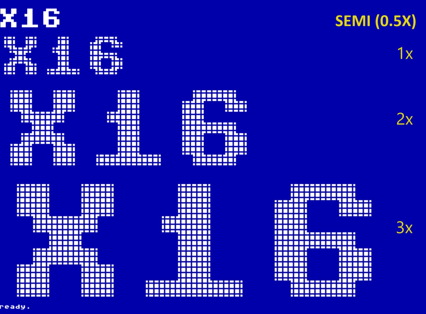

Here are some examples of the BigFontSemi and BigFont output results.
Program could be extended to make use of BANKs for even larger conversions, but for now just BASIC "lo-RAM" is used (so limited to about 28K or so). Also if writing to the screen, it may be possible to inject CBM color codes between the letters.
Since using BASLOAD, can be easy to adjust BigFont to alter the desired scaled symbol to use.
And the output can be altered if using SHIFT+ALT or ISO (ALT+O) mode to adjust the font (since the currently load font is pulled directly from memory when scaling).
