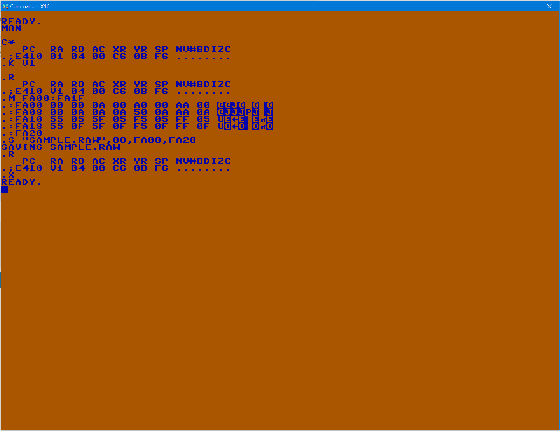

I wrote some code in BASIC to write to a palette, and looking for a lazy way to spin it out to a file that I can use BVLOAD later.
(I'm aware I could just write it out sequentially to a file instead or in addition to poking it in, but I want to be lazy)
Thought I'd try using the monitor but it looks like it's not saving from VRAM.
Reproduction:
1. Mess with the palette (tokenized EGAPALETTE.BAS will do)
2. Enter the monitor, enter some commands (a sample is included in the picture)
3. The output data looks way off from what the memory view showed (attached as SAMPLE.RAW inside the zip file, sorry, can't attach raw files)
Running on the emulator, haven't tried on hardware. I'm not sure where the data comes from, but the sample doesn't match the display at all.

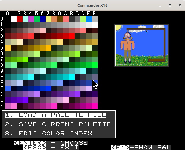

You might want to look at my game HANGMAN
viewtopic.php?p=30065#p30065
I threw the Kitchen Sink at this one. Among other things I did a Wysiwyg Palette Editor in BASIC into the mix.
It's a separate program from the main game. It's written using BASLOAD format not line numbered but it
is in BASIC.
There is a PAL2FILE subroutine in the Palette Editor.

The K command lets you select a vram bank but I don't know if save/load respect that.

ahenry3068 wrote: Tue Nov 05, 2024 8:02 am You might want to look at my game HANGMAN
is in BASIC.
Can't get easier than a tool already written! Thank you!

Admittedly I didn't check all 512 bytes of the palette area, or the greater VRAM in general, but from the small 32 bytes I checked out, it looked like a match. That I might have gotten lucky and found a section of main RAM that had those same values doesn't seem likely.

The problem seems to be simpler: the monitor uses the plain Kernal LOAD and SAVE routines for the L and S commands. The monitor hardcodes L to always load to system memory (not the VERA), and SAVE can only read from system memory anyway.
So, while the monitor can be used to dump the contents of VRAM to the screen, there doesn't seem to be a way to use the S command to dump VRAM to a file.
You yourself would need to copy your data out of VRAM and into system memory first, then you could save that to a file.
