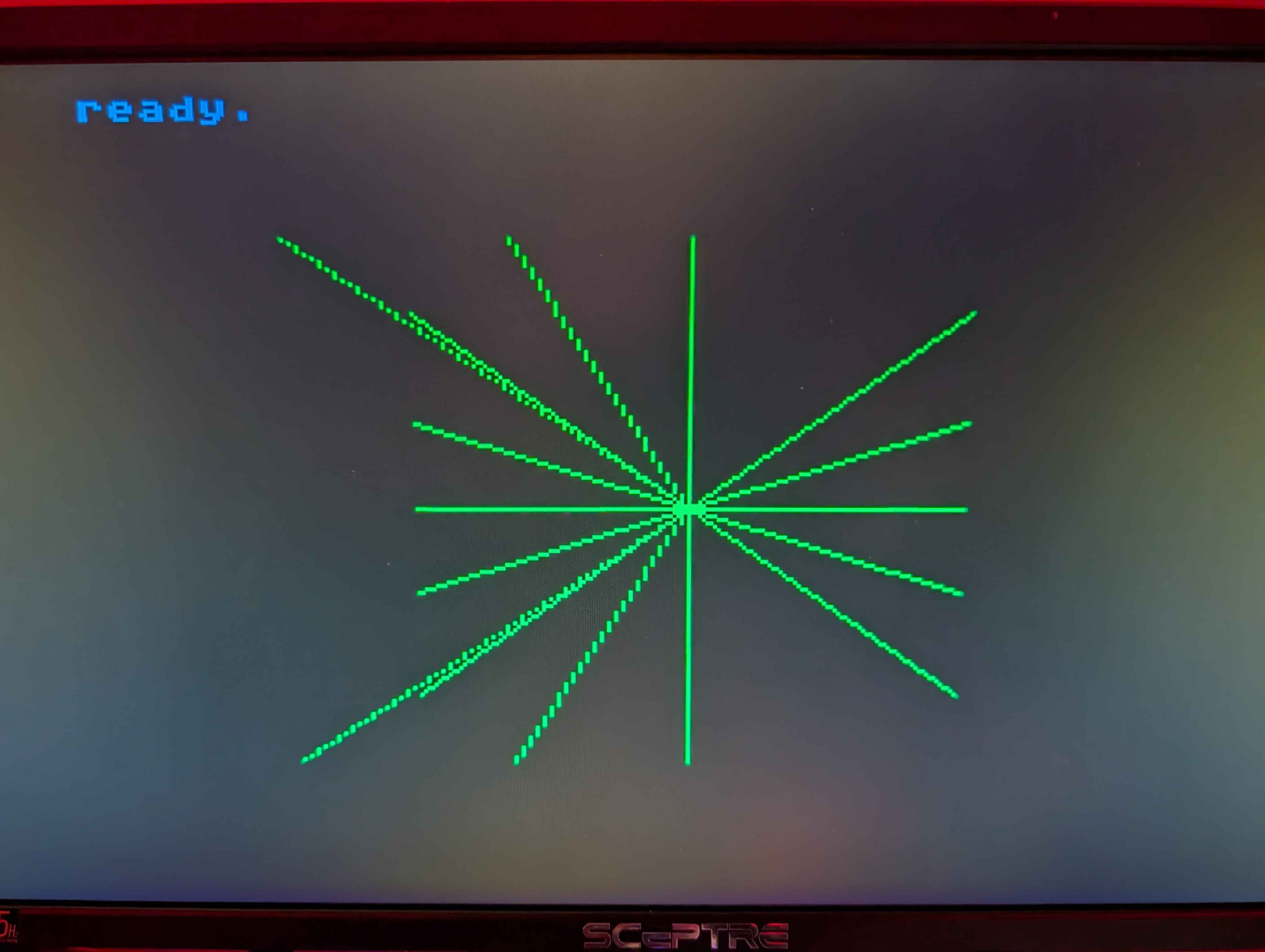

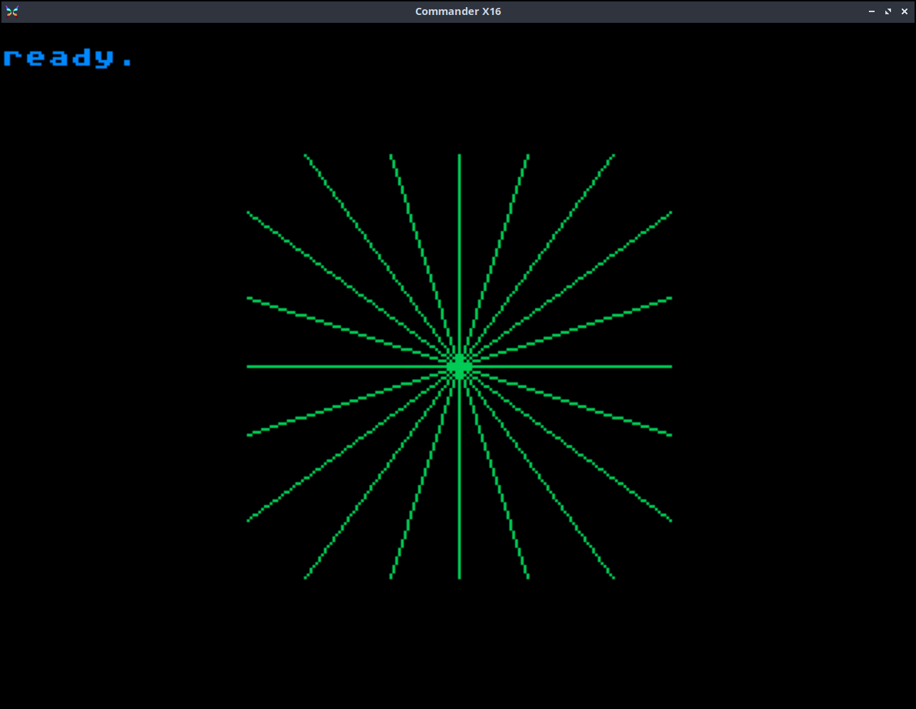

In my Google Drive is a program SAMPLE.PRG which draws lines at 4 bpp using VERA FX https://drive.google.com/drive/folders/ ... sp=sharing. Attached are outputs from an emulator r48 (the PNG), and actual hardware (the JPG). The emulator is correct, while it was confirmed there is an issue in VERA. Four octants are affected, those where it is occasionally incrementing or decrementing the horizontal direction by a nibble, while always incrementing or decrementing the vertical direction by 160 bytes. The forward horizontal direction doesn't seem to work at all, while the reverse seems to have a byte instead of a nibble increment.

Re: Request to try out demo in progress on real hardware
I see, it was because of how ADDR0's half-increment was implemented.
If ADDR0_INCREMENT is 0.5, and ADDR0_NYBBLE is LEFT (0), then ADDR0_CHANGE is 0.
If ADDR0_INCREMENT is 0.5, and ADDR0_NYBBLE is RIGHT (1), then ADDR0_CHANGE is +1 byte.
If ADDR0_INCREMENT is -0.5, and ADDR0_NYBBLE is LEFT (0), then ADDR0_CHANGE is -1 byte.
If ADDR0_INCREMENT is -0.5, and ADDR0_NYBBLE is RIGHT (1), then ADDR0_CHANGE is 0.
When using ADDR0 to "sometimes" increment ADDR1 (as in line-helper mode), it tries to add ADDR0_CHANGE which is calculated based on ADDR0_NYBBLE instead of ADDR1_NYBBLE, so you get the effect of -0.5 always decreasing by 1 byte, and +0.5 doing nothing. In fact, if you changed ADDR0's nybble to RIGHT instead of LEFT ($9F22 bit 1 = 1), you should get the opposite effect where +0.5 always increases by 1 byte, and -0.5 does nothing.
I'm one of those weird people who really wants to understand why the original implementation was wrong whenever there's a bug like this.
