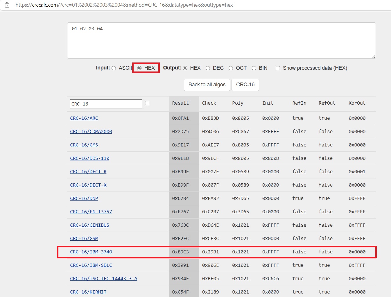

With a starting CRC of $FFFF, the binary string $01 $02 $03 $04 should evaluate to $89C3.
But, when I use this - I think I'm giving a string as described above, but the CRC result is $6122 instead of $89C3. So, not 100% sure if I'm using this right.
EDIT: Tentatively, it looks like the KERNAL code is "seeding" the CRC with $FFFF ? Just based on the first few lines the LDA #$FF and storing those into R2 (which is the output register).
And, I have reason to believe the $89C3 might be correct, based on this site that does a bunch of variety of CRC16 results (it matches the old IBM3740 version). There are a bunch of different ways to do CRC16 (I mean constants to plugin), and I wanted to understand which variation the KERNAL is doing - which then from Python or C# or Java or something I'll need an equivalent CRC16 calculator {or write one}).

Yes, KERNAL generates a CRC-16 that matches "CRC-16/IBM-3740". I used this online calculator to simplify the task of precompute the checksums for different versions of the SMC bootloader, ref https://github.com/X16Community/x16-smc ... r-tools.md

Which this example results in showing 0x89c3
