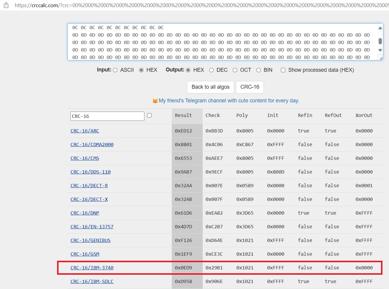

Re: KERNAL CRC call (not sure if right)
Ok, confirmed, the behavior is as expected for a larger example that is >255 bytes.
Here is a BASLOAD example that demonstrates this. It writes an expected static set of data into BANK RAM. I tried doing POINTER(x) of a DIM'd array, but I wasn't yet able to really decipher what the returned pointer in that case is (specifically something like DIM SAMPLE%(1000); I'll just say the returned address in that case seems a bit odd and I couldn't reliably get to the array'd data). So instead, this gave me an excuse to exercise the KERNAL memory_fill function.
This results in $0ED9.
Attached is the intended sample data, represented in a hex sequence. Feed that sample into the reference CRC website, and we get an independent matched result.
The Python and C code earlier also matches this result. The data was prepared with a simple loop like this;
Again, this is for "large data" cases (>255 bytes).
EDIT: I also repeated the above, reducing from 4096 down to 300 bytes - and everything matches (consistent CRC for that case). So yes, as coded in the KERNAL there is this different CRC behavior between the 255/256 byte threshold.
I'm not sure I'd call this a "bug" in the KERNAL - I guess the community can mull it over and decide. Obviously, someone went out there way to make the behavior that way. And it's not a crash-causing issue, so under the "no breaking changes" rules we could just lean towards this being known behavior now.
