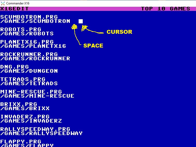

So I got a headache for a program working in the emulator & not on real hardware..
For what it's worth, I know it's not a perfect world.... just if any1 else runs into the same issue....
Files that use the OPEN# & CLOSE# statements can be seen differently...
The Emulator ignores spaces & real hardware doesn't... (Well thats what I'm seeing)
I've used the OPEN# to get information from this file to load programs.
Because there's a space behind the cursor.
It gives a "FILE NOT FOUND" on real hardware...
But works on the Emulator...
That's all it was.... I don't know if its worth doing anything about.... but Iv'e posted it.....
It might save someone-else some time
But there's definitely a difference on real-hardware & the emulator !
Best Regards
Shaun
