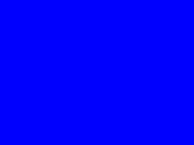

Fun Fact: The game levels are little isolated games in themselves, so you can skip to any level without finishing the previous level, using code. So if I set the first level to be the end of the game I get this:
Oh and BONUS here's what it looks like using box16:
GIF 2-02-2025 9-17-58 PM.gif (1.31 MiB) Viewed 15277 times

What screen resolution are you running in here. ? I'm curious.
I've learned a couple of tricks in my Movie Maker and video experiments to prevent screen glitching when your taking longer than Vsync to do a frame. Maybe I can help a little.

Thanks for compliments - it keeps me motivated :)
Do you mean my desktop or the game resolution? I'm using the gif recorder from the emulator. I don't actually own a CX16 yet. The original game was 320x200 on the Amiga. It's the same res on the MS-DOS version (where my assets come from). The CX16 version actually runs at 320x192 (4-bit) with the bottom 8 pixels cropped. There's a few reasons why, but the main reason is the 2048 byte alignment that the VERA requires to set the offset to display in bitmapped mode.
The second reason is that the game requires 4 display buffers, and the VERA only has $1F9BF or 129471 bytes of memory.
Page size 320x200 = $8000 ($8000*4= $20000 == overflow)
Page size 320x192 = $7800 ($7800*4= $1E000 == no overflow with 6591 bytes spare)
I haven't crunched the numbers yet, but I'm hoping that's enough space (with alignment) to fit the text mode in for layer 1.
Thanks for the offer on helping with timing, I'm hoping I'll be able to work it out a bit more on my own, but I'll keep it in mind if I really do hit a wall. At worst I think I'll just lower the game res to 256x192 which means no more 16-bit calcs and instant speed boost.
Oh and my desktop in the screenshot is 1440p :P
