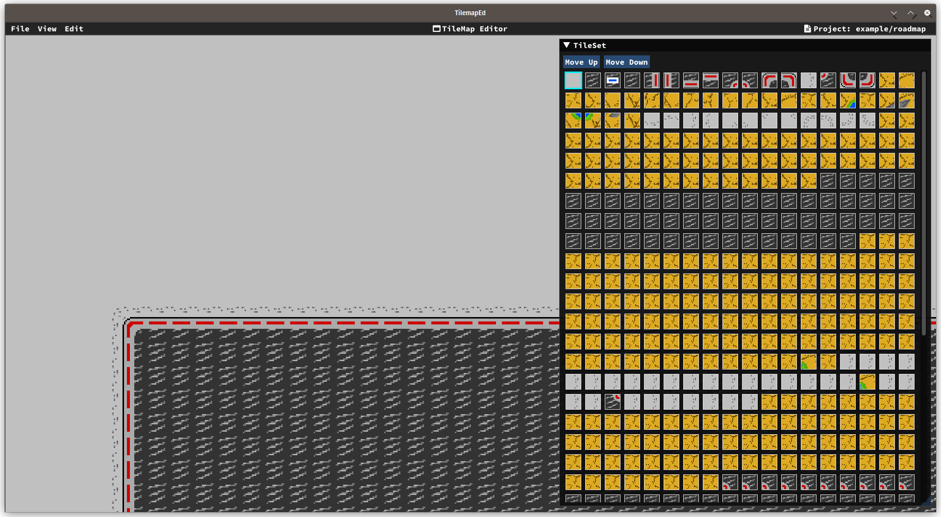

I just uploaded version 1.8.149 to GitHub, which has some feature updates.
The TileSet Window now has a "Maximize" mode, where it can be as large as the user wishes.
When maximized the "TileSet Edit" menu only contains one item, which is "Tile Scale".
The reason for this is to help with tileset reordering etc. on very large tilesets.
Another update is that the Dear ImGui "imgui.ini" file is now saved to and loaded from the Project folder.
This means that e.g. the maximized state of the TileSet window is saved for each project.
Before the "imgui.ini" file was always created automatically in the current working directory.
A screenshot of the new TileSet window:
