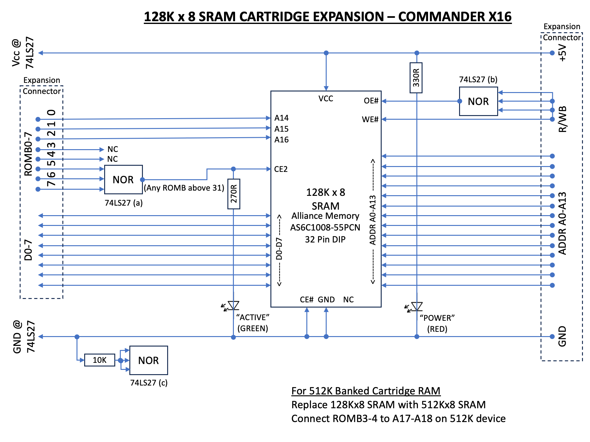

Martin Schmalenbach
Posts: 145
Joined: Tue Jul 21, 2020 10:08 pm
Re: Expansion slots
Post by Martin Schmalenbach »
Just so I'm clear from having followed this interesting & spirited discussion...
If I WRITE to the banked ROM space for banks above #0-#31 and I have an expansion card with RAM mapped in to the ROM space, the data that is written by the CPU will actually be stored in the RAM, assuming I've wired the RAM up correctly?
The application I'm thinking of here is. simple Expansion card with RAM occupying several ROM banks at #32 and above that will be useful for speedier development of ROM-based code for cartridges etc.
Something like the circuit below/attached
Cartridge RAM in ROM Banks
spargue
Posts: 29
Joined: Thu Apr 13, 2023 8:56 pm
Re: Expansion slots
Post by spargue »
Martin Schmalenbach wrote: Fri Jun 30, 2023 4:34 am Just so I'm clear from having followed this interesting & spirited discussion...
This seems OK, I wouldn't put the activity led on the OE line as this is bad for rise fall times, better to buffer it with the extra gate. Not sure how you'd program it unless this is just a simplified sch
spargue
Posts: 29
Re: Expansion slots
Post by spargue »
Oh wait I just saw an issue. You need to watch A15 A14 from the slot to see if you are accessing the rom address space. Not (A15 & A14) - > #CE
Martin Schmalenbach
Posts: 145
Re: Expansion slots
spargue wrote: Sat Jul 01, 2023 10:20 pm
Good catch on the activity LED - thanks!
