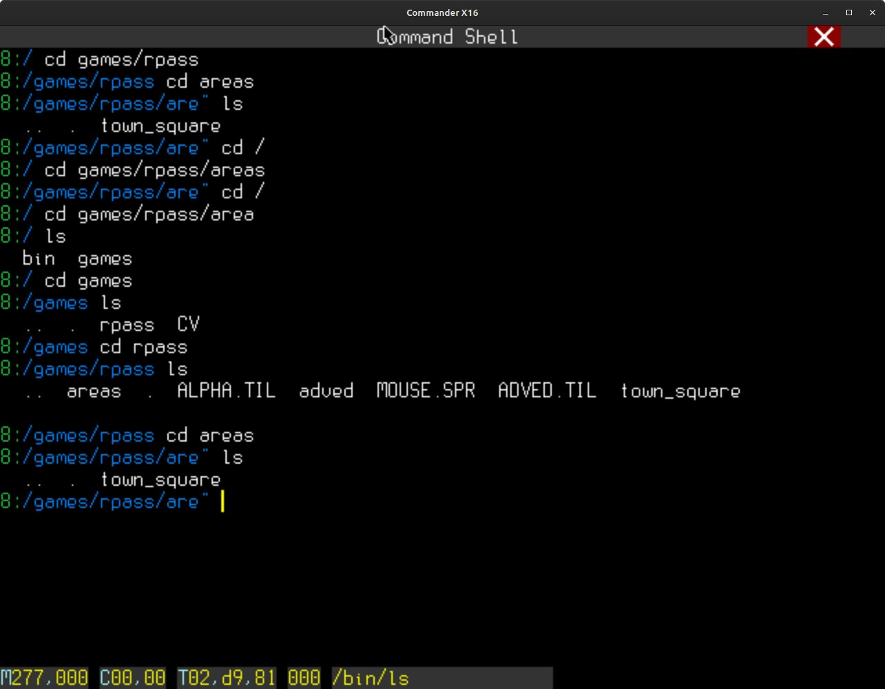

Oh, yeah, I should have know the parser was in the parser module. In hindsight... yeah.
Anyway, I was wondering what would happen when I got a path that was longish. I noted that in BASIC, the DOS calls just shortened the path to 16 characters. Well, that happens here, too. As you can see in this screenshot, the "full path" is still stored, and you need the full path if you're going to type it in in one go, but you can always do it incrementally as well.
I think a lot of "shell development" is going to be dodging around the limits of the fat32 implementation in CBM DOS.
Another detail that you can't see here is that there are only 2 "file types" reported, DIR and PRG. as such, I can't tell the executable files from the "regular" files without opening them and looking for the header bytes. But I can detect DIR entries with precision, so the next step is to color code those blue so the user knows they're directories.
- xsh_dir_length.png (45.33 KiB) Viewed 19916 times

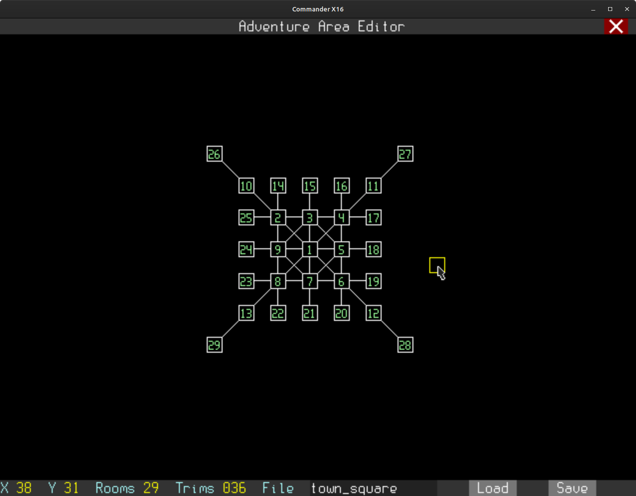

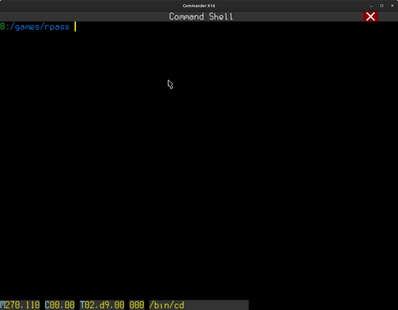

One of my goals here is to create an environment that makes it easier to edit the plethora of file assets needed to create a game on the X16. For that you need a shell that lets you navigate the file system, then a way to run the tools that edit the files that define game.
This first shot is the user about to start editing a part of the game world for "rampart pass" (A game I'm working on.) then the editor itself, then when the user is done, closing the editor with the "X" in the upper right drops them right back to the shell.
