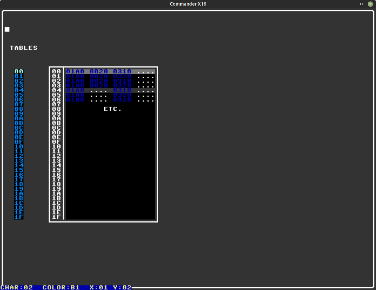

Now that FM has some effects and things, while there are still more to add, I want to look at another big feature (perhaps the last one before thinking about a 1.0), which is tables. This is a prototype preview UI screen for it:
Tables would work much like they do in LSDJ. They are a way to effectively do multiple effects at once, and have fast effect evaluation for the potential for doing fun things. They run at the engine speed so for VSYNC that would be 1/60 - same speed as envelopes, sweeps, etc.
Each table will be 256 bytes with support for 32 tables (8k total). This keeps the table lookup math easy (just like for envelopes). That 256 can be arranged any way I want and I'm currently pondering having 4 effects per row (32 rows total) vs 8 effects per row (16 rows total).
Curious for fellow tracker musicians which option seems more appealing? I can't think I've ever run into a case where I needed more than 4 effects in something like FamiTracker but likewise I also haven't needed more than 16 rows in LSDJ for doing something. One use case I was thinking is tables can be a nice way to get the SID style drum sounds. 16 rows would be plenty for that.
I forgot to say tables will be either loopable or one-shot but I haven't decided how best to do that but am leaning on using the pattern cut, loop, and stop effects to do that.
Any strong feelings from folks?

not a musician, and not really used a effect tables before.
Fami(0cc) Adtracker // and Furnace all got instrument(or macro tables) based marco.
But if I were to convert inst. macros to effects only, like there's a famitracker demosong in which instrument is default 2a03, and all the wave setup is done by effects.
I'd say 4 effects should cover most cases, one for volume(ADSR) one for pwm/waveselect, two more for fun.
But if count in some crazy PSG instruments and elephant in the room FM, effects could get complex very quickly.
So maybe 4 is enough.

I'm planning on having tables for both PSG and FM though the FM may prove more limiting due to the write speeds. Not entirely sure about that one yet. I'm trying to make sure shared effects are using the same effect numbers which means tables can be used on both. The tracker will happily let you mix and match even in cases where the effects don't match which could be interesting.
FM will probably have have more total effects than the PSG due to having more settings. I could expose nearly every register out to an effect value for instance. Not sure at what point the write limit starts becoming a problem but that would otherwise allow for a lot of manipulation where I could see more than 4 slots being maybe useful. Indeed for the PSG 4 is certainly more than I ever used in Famitracker as in pattern effects. Though old Fami didn't have engine speed tables as I recall - just envelopes (which I have too though I haven't implemented the pitch env yet).
I opted to do tables first as they cover the case for macros. Though if I only had 4 slots and someone wanted more, a one shot macro effect is one I had thought of as well (with or without tables). That would be another way around the per row effect limits.
Anyways 4 effects and 32 rows is what I was leaning towards but figured I would ask to see what folks thought.
