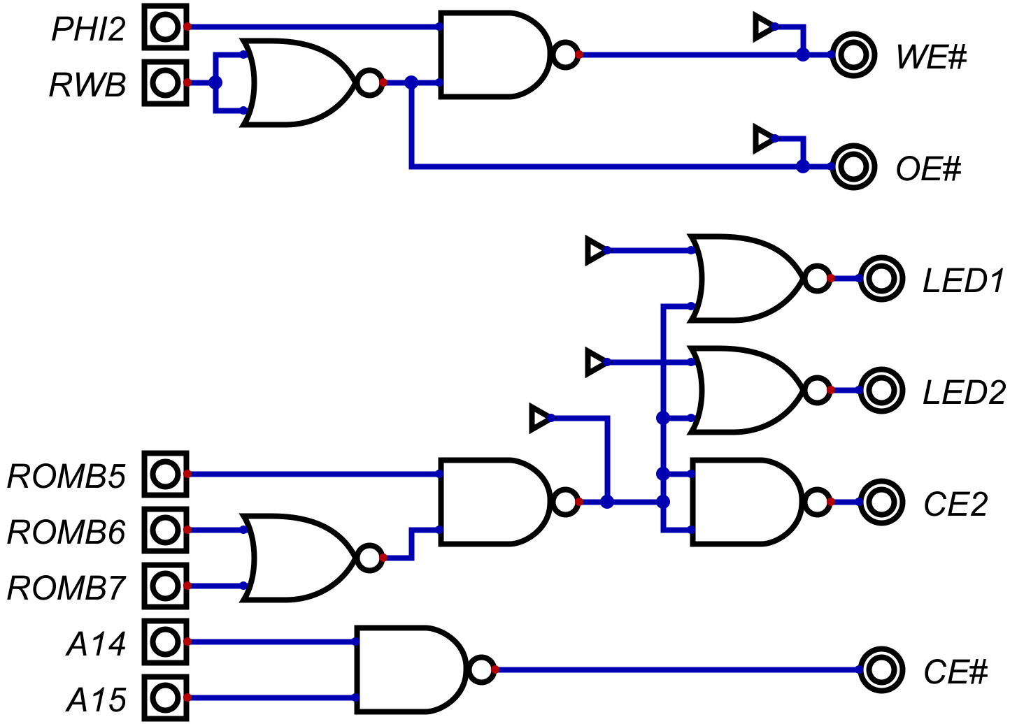

spargue wrote: Sat Jul 01, 2023 10:24 pm
Martin Schmalenbach wrote: Fri Jun 30, 2023 4:34 am Just so I'm clear from having followed this interesting & spirited discussion...
If I WRITE to the banked ROM space for banks above #0-#31 and I have an expansion card with RAM mapped in to the ROM space, the data that is written by the CPU will actually be stored in the RAM, assuming I've wired the RAM up correctly?
The application I'm thinking of here is. simple Expansion card with RAM occupying several ROM banks at #32 and above that will be useful for speedier development of ROM-based code for cartridges etc.
Something like the circuit below/attached
Oh wait I just saw an issue. You need to watch A15 A14 from the slot to see if you are accessing the rom address space. Not (A15 & A14) - > #CE
Yes - I see that now - another good catch - thanks!!
spargue
Posts: 29
Joined: Thu Apr 13, 2023 8:56 pm
Re: Expansion slots
Post by spargue »
On my PC now and not on my phone.
Noticed the WE doesn't use the PHI2 edge.
WE# needs to end slightly early to grab the data or it all collapses in a fuzzy way and you get bad writes.
OE doesn't need this latch as its grabbed from the CPU internally on PHY2
I'd recommend some inline resistors on the data lines 33R should be ok as it helps with noise and contention.
bank select.png (91.29 KiB) Viewed 363747 times
INPUTS to LED 1 & 2 gates can be connected to WE# OE# or CE2 pre gate to give the bank active read and write activities

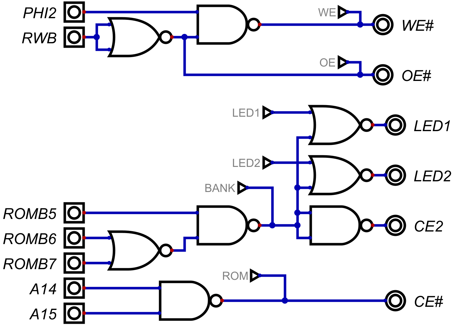

Martin Schmalenbach wrote: Sun Jul 02, 2023 5:02 pm Thanks Spargue!
I’ve just sat down with a coffee and breakfast burrito at my local reservation breakfast shack to look at finalising this design when I saw your additional post here - much obliged. I hadn’t realised WE# needed to end a tad early so thanks for that.
One thing I’m not sufficiently clear on - the small triangles in your schematic - I take it these connect together to drive the LED activity and you didn’t draw those lines in for the purposes of clarity?
Cheers
Martin
Wasn't sure if you wanted the LED for bank selection or for activity on the SRAM, Have uploaded it again with labels.
Just connect LED1 or 2 to WE, OE, BANK, or ROM to indicate when the system is writing, reading, or accessing the CART.

Martin Schmalenbach
Posts: 145
Joined: Tue Jul 21, 2020 10:08 pm
Re: Expansion slots
Post by Martin Schmalenbach »
Got it - thank you!!
I suspect I have just enough time to layout a PCB and get it manufactured and built before my X16 arrives from Texelec!
