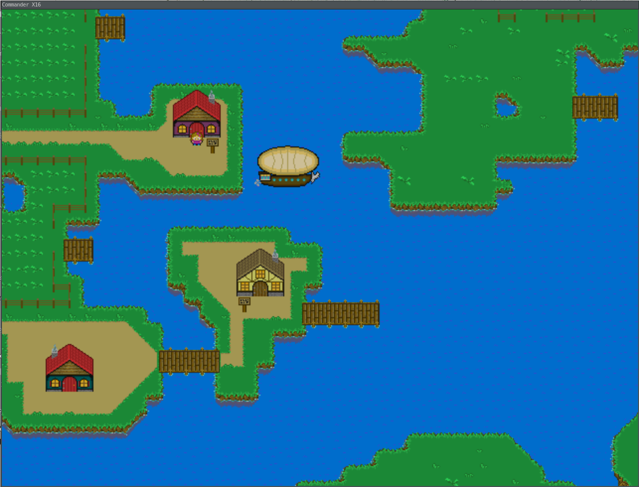

I don't know if that's really a fair assessment, given that the VERA has 128k of video RAM. That's twice as much RAM just for video than the C64 had for everything. You aren't going to be displaying a 640x480x8bpp bitmap, but you can absolutely do 2 layers of 16x16x8bpp tiles on a scrolling screen that is 128x64 tiles in size, using 256 individual tiles in the set. I know this because with a single line change, I'm staring at my own game running in this mode right now.
Unless I'm mistaken, this is pretty much unheard of for an 8 bit system.
What I've learned is that you can choose which way to limit yourself. You can restrict the number of tiles in your set, or you can go down to 4bpp/2bpp modes, or you can shrink your playfield and replace tiles on the fly, or any other number of tricks to fit more graphics in a limited space. But still, I'd hardly say that 128k isn't much VRAM.
