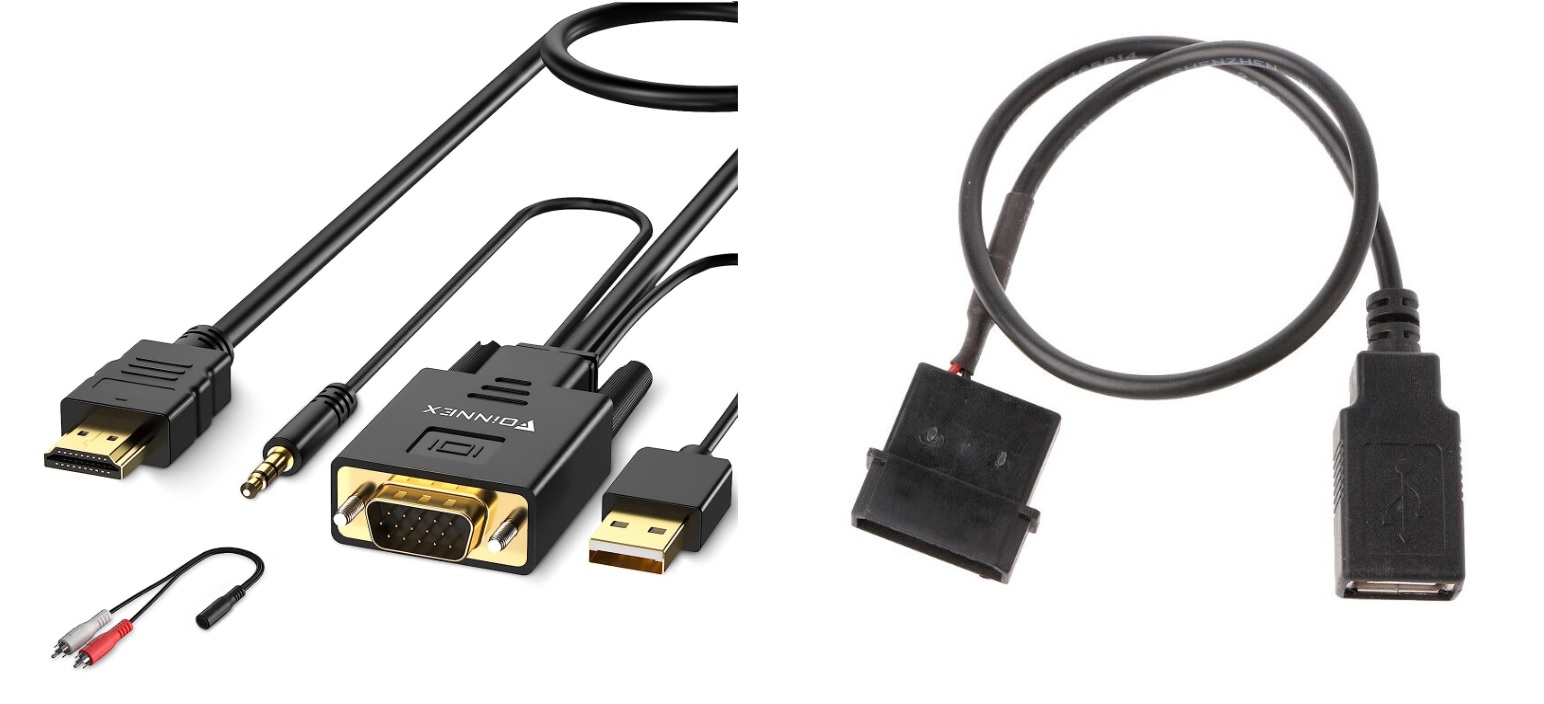

This one works for me (and under $20 for the 1.8M cable, about 6ft):
FOINNEX VGA to HDMI Adapter/Converter Cable with Audio,1080P,Convert VGA Source (PC) in HDMI Connector of Monitor,TV. Active Male VGA-HDMI Out Lead Video Adattatore Cord for Computer,Laptop,Projector
https://www.amazon.com/dp/B071SHJ1S3
The audio plug goes right into the X16, easy. You might need an extension for the USB plug, or you can connect the USB to the picoPSU using something like this (remember on the Molex connector, RED is the 5V side and yellow is the 12V side):
https://www.ebay.com/itm/374806020555
I've ordered about 4 different picoPSUs (70-90W) and they all come with little SATA and/or Molex adapter outputs for power. I've used these to power 12V monitors, the speakers, and things like the IEC disk drive adapter, so the system just needs one main power connector to AC outlet.

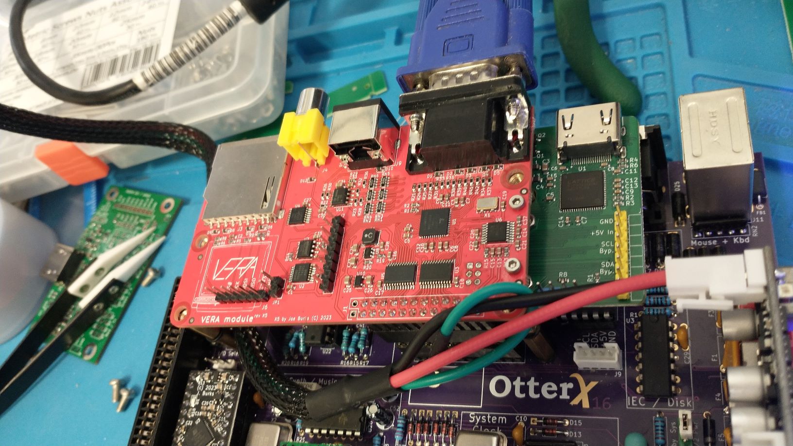

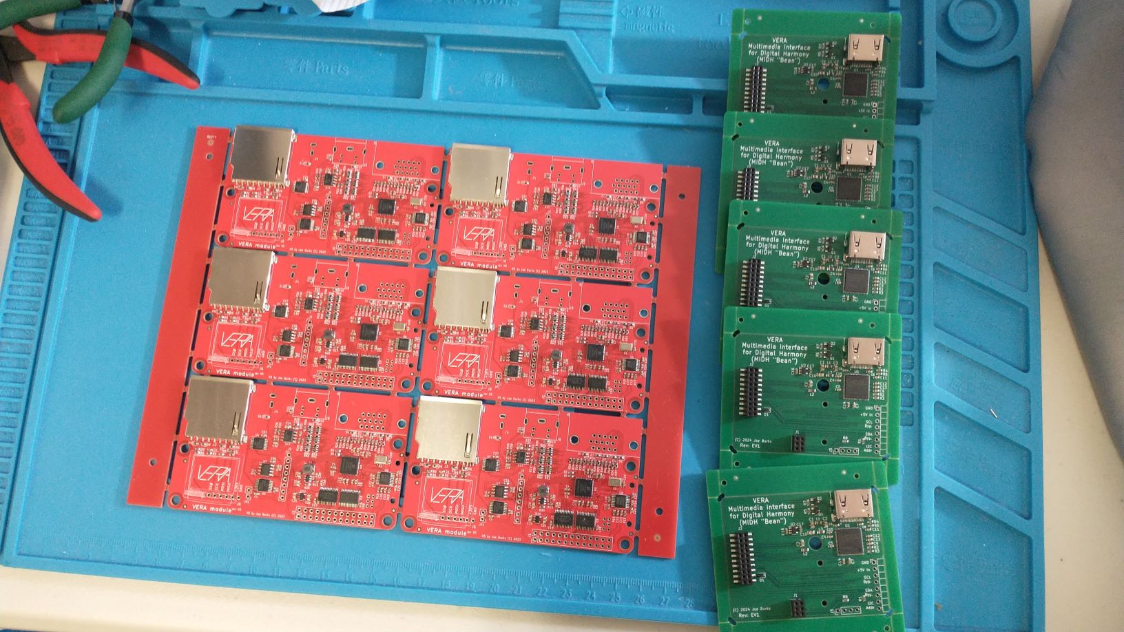

Somewhat related: I've been working on this module which uses the SiI9022ACNU, attaches to my VERA X5 boards, and provides a digital input to "HDMI compatible" output path.
Unfortunately it doesn't fit so well in the system:
And not every TV wants to pillarbox the image:
It's still a work in progress which I'm not certain will ultimately be successful. I'm still trying to learn enough about HDMI to validate everything that I'm doing. I set the AVI InfoFrame to tell it that the image is 4:3 and should be pillarboxed, but it didn't seem to help.
