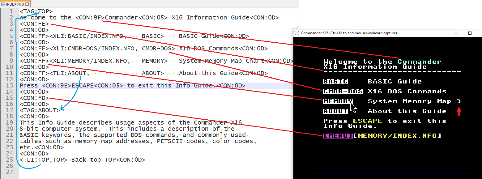

Here is a screenshot to try to explain the mark-ups.
Some rules:
- all mark-up command tokens must be upper-case
- all spaces in the target description will be ignored (so you can still use spacing to help align things, but they won't appear in the presented output)
- any \n or \r in the input .nfo are ignored. The output will only newline when it encounters the CON:0D code (as shown below).
<TAG:xxx> defines a tag target starting location that are the target of TLI (TLINK, TAG LINK) commands. "xxx" name can be up to 40 characters.
<CON:yy> defines a control character output. These are hex values and can be PETSCII color codes, or there are a few "special codes" that are interpreted on display. FF = disable word wrap (until newline), FE = make a divider line across the current row, FD = force a menu pause (to enable link selection).
<XLINK:target,description> is a link to an external file, target is the absolute or relative path (relative to the CWD from where XINFO was RUN from). Target can be up to 80 chars, description up to 60 chars. Spaces in this description are ignored on output (so use a dash).
<TLINK:target,description> is a link to another tag within the same document. Note that for both external and tag links, the same style of "REVERSE COLOR" is used to highlight that they are left-clickable link regions. And also in either style of link, the link target is shown at the bottom by the menu (at least the portion of the target that can fit on the width of the screen).
In the example below (which is using SCREEN 11 32x25 mode), word wrap is disabled (CON:FF) for the list of items. If any of the strings on that row goes beyond the current screen width, a ">" arrow is shown at the edge of the screen automatically. In most cases that content won't be critical to the users, but they can be aware it exist and switch to a wider text mode if they wish.
