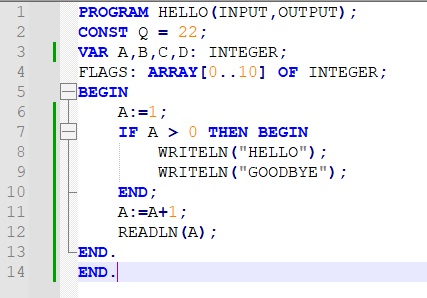

For anyone trying this and having problems, today I discovered a bug, but one that occurs for unknown reasons, which I haven't figured out. What will happen is that the compiler will parse the source text, apparently completely, but then just sit there. It appears to hang on the terminating 'end.', adding another 'end.' appears to fix it. I spent a number of hours trying to figure out why it happens, without success. As I say, it doesn't always happen, but if you see these symptoms and don't find any other 'syntax' errors, try adding a second 'end.'.
Also, the interpreter executes the program and when the program is finished, the interpreter exits, so you need a readln(); or forever loop at the end of your code, to see the results.

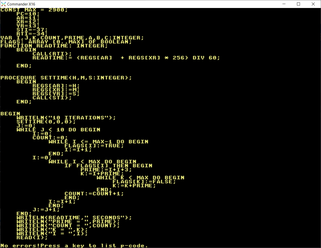

I was hoping to have remarks working, but it continues to evade me. Here is a new updated version (in original post) , some fixes and enhancements. A few new 'standard functions' added to make all of the 'non' Pascal standard function/procedures:
Call - call a kernal routine
Clear - clear text screen
Rand - return a random number between 0-255
A few new examples to demonstrate the new function/procedures.
Here's a minor question. I made write/writeln use the double quote instead of the single quote, since that's the 'norm' for the Commodore lineage, should I change it to use single quotes?

Here is the latest build of Pascal-S. I have added the keyword/command 'GOTOXY', which will enable positioning the text cursor for text output. I also changed from double quotes to single quotes inside writeln. Additionally, I added being able to perform bitwise 'and' using the & symbol. I think that Turbo Pascal used 'and' for both boolean and bitwise operations, but this was the easiest path for me. I will be adding or,xor, and shifts. I will use SHR and SHL for the shifts. I have included a program that showcases these new features.
Updated p-compile.prg and p-interpret.prg are in the .zipfile in the post at top.
