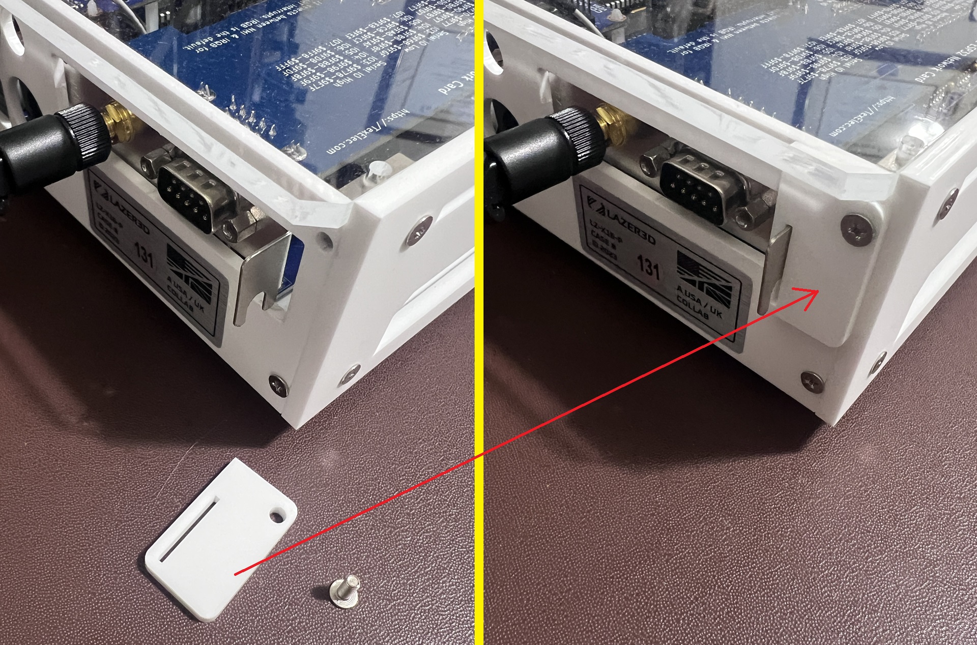

  • The random white square with the slot in it is for when you mount an expansion card; it goes on the outside when you do.

I'm still not getting the random-white-square, even after having the serial-network card expansion.

For that random white square with the slot in it; if you go to the order page for the Lazer3D case, and look at the photo of the backside, you can see it all the way on the right, with the expansion card's metallic bracket fitted into it. I don't have an expansion card so I don't know how useful it is, but it's definitely shown there.

"random tab" goes like this...
