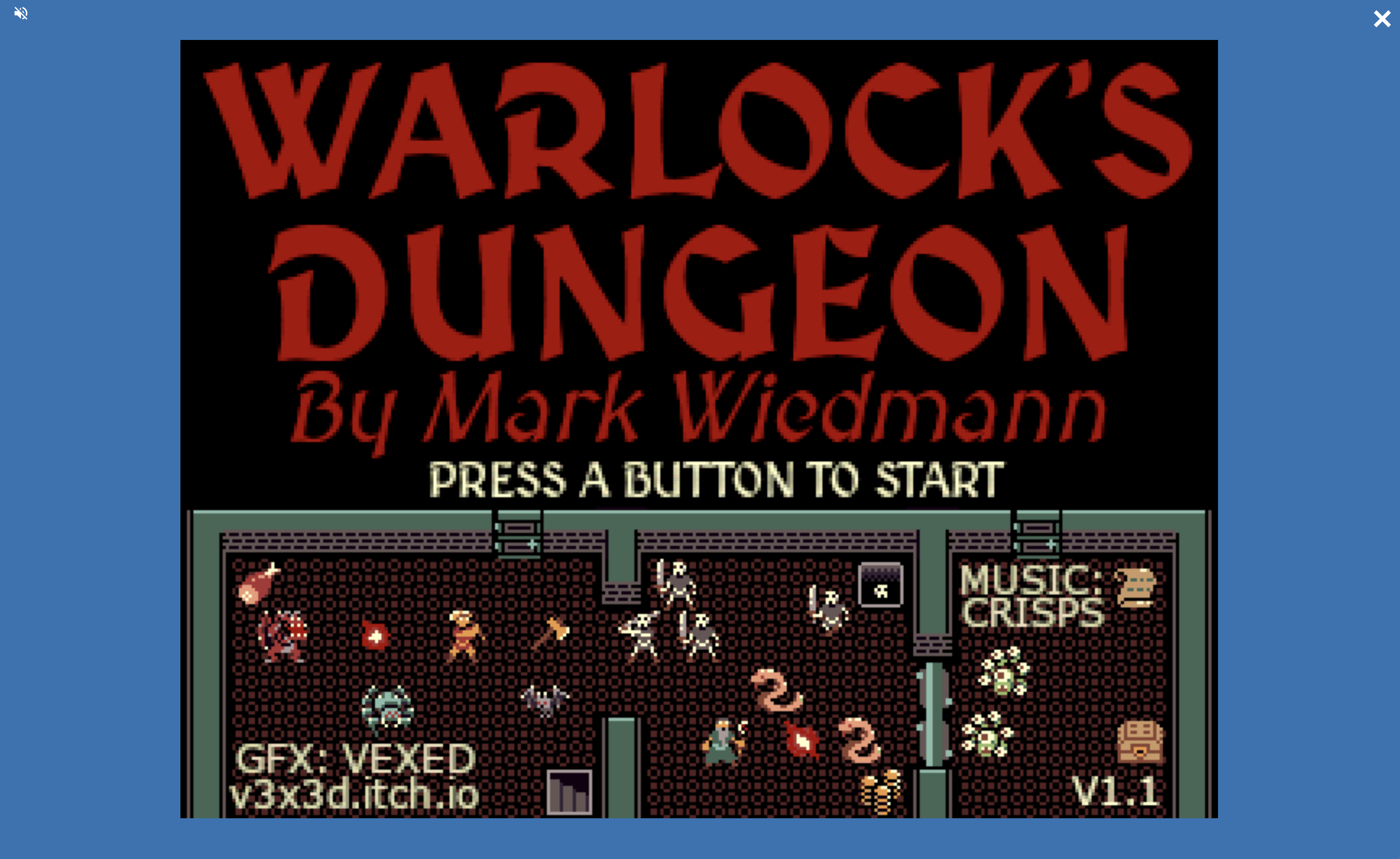

I'd like to suggest changing the current background color of the Web Emulator.
It is currently set to #2773b3 (pale blue) which can take away from a game's aesthetic appeal if the color palettes are different. See example attached.
I suggest changing it to #000000 (black). A neutral color will always work well.
Background color does not fit the aesthetic of the game
Screen Shot 2025-01-04 at 10.39.44 PM.png (1.43 MiB) Viewed 17666 times

What if it used the VERA's current border color instead?

Interesting, what is the default value for this register? I haven't considered this register before.

The default is 0 (in the default palette, black).

The border color is 0 by default, but users are allowed to choose a different color in the X16 menu.
The border is also not visible in VGA mode unless you resize or change the active area of the screen.

If the default color is black and it can be configured by the dev or user, then I like this approach!

This was a common problem even back in the 90s with VGA DOS games, the border was picking up whatever color the first index of the palette was using, but VERA has this awesome register that can set which palette index to use for the border:
BORDER_PAL_INDEX = 0				; Use any number between 0-255, select the color that most suits your game!
	lda #BORDER_PAL_INDEX			; Border color is only inactive display!
	sta $9F2C				; Though, make sure DCSEL=0 before writing to $9F2C
Like conversion programs or gif image editors put whatever color they want in palette index 0, this has no affect usually, but I have seen horror when they put white there and the image is loaded with VGA. I am pro-border hardware, and I am designing my game with the border in mind since day 0.
