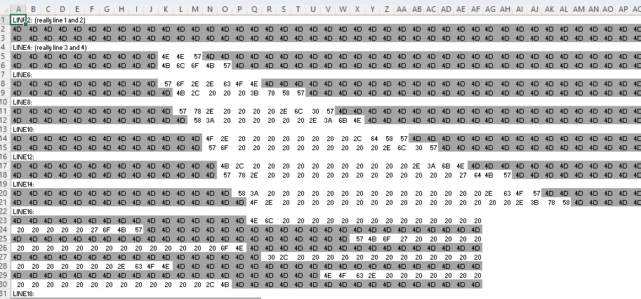

Also, if the long BYTE sequences don't make sense, attached is an Excel version that will help it make sense.
logo.xlsx

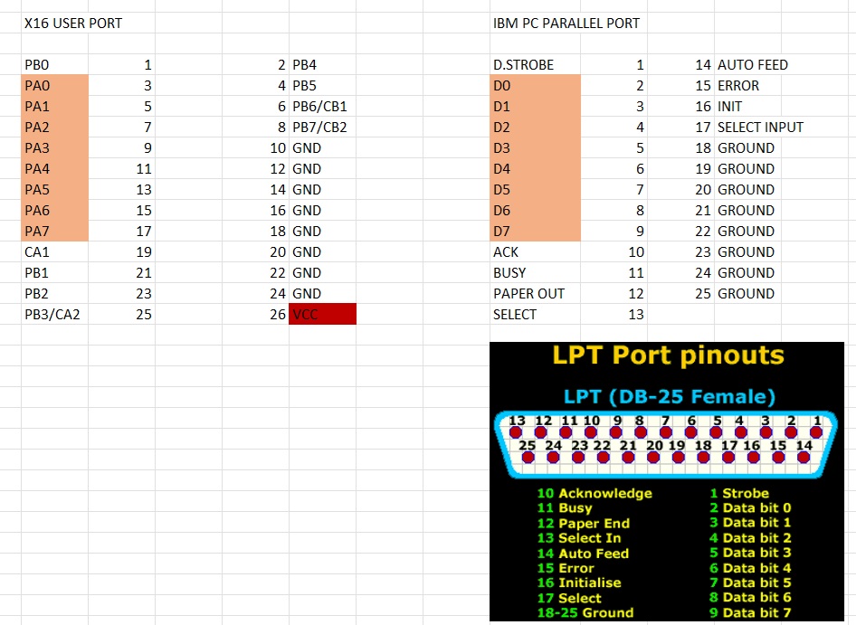

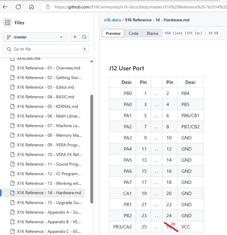

The actual UserPort pinout is
https://github.com/X16Community/x16-doc ... ardware.md
or as follows:

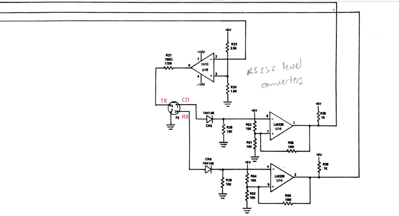

Note that technically you could "bit bang" RS-232 out of any pair of these data pins, but said pins would then also need to be connected to a 'level shifter" to be interpreted as RS-232 by the connected system. And this would be full-CPU and yield at best 9600 baud.
(the CD carrier detect is mostly optional)
Something like this (to go from 5V TTL to a -12V to +12V swing):

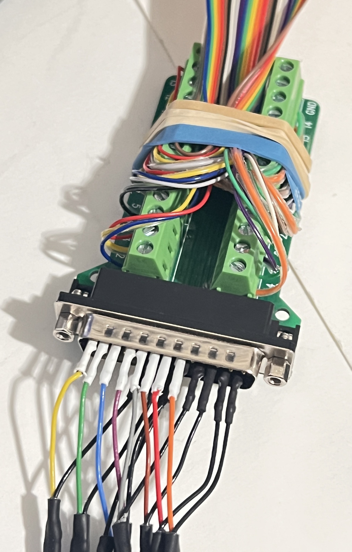

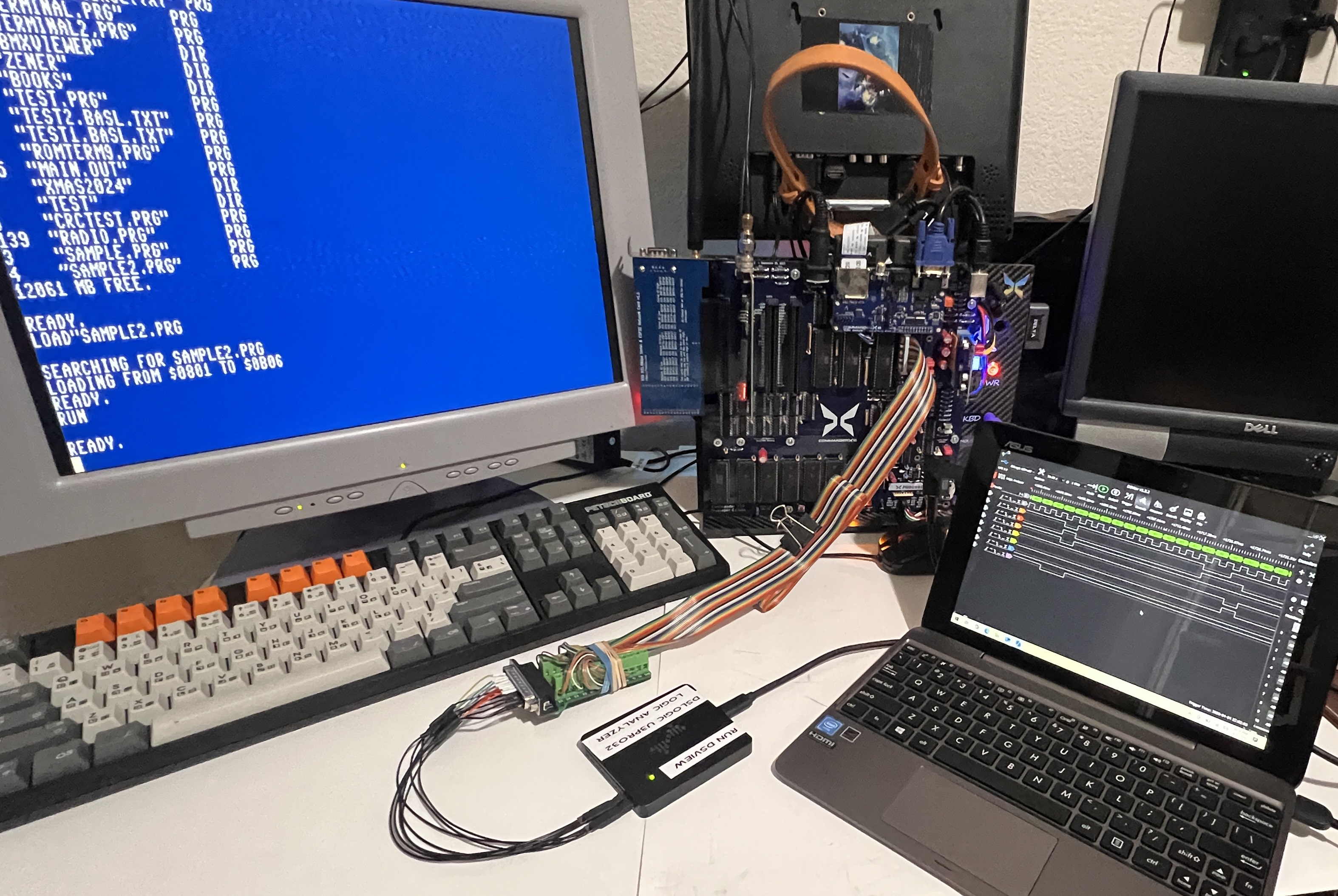

Hooked the X16 UserPort output up to a logic analyzer. I'm not aware of any ready-made 26-pin to DB25 25-pin adapters, so got one of those green "breakout box" adapter things to wire it up myself.
I was messing with LAPLink and FileMaven recently for something else, so got to thinking a similar thing ought to be possible here.
Confirm on a logic scope that all the expected bytes were getting received. I also messed with the ParallelPort Tester under Windows XP, saw some blinky lights there going.
sample2.a.txt
(6.94 KiB) Downloaded 145 times
